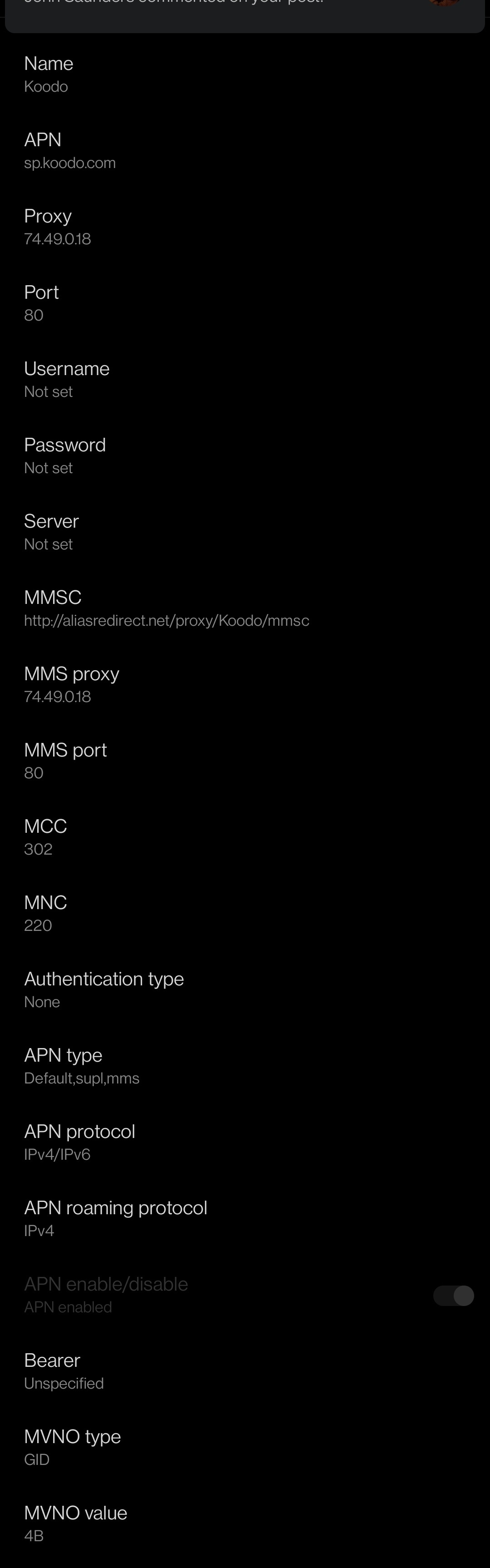

Just upgraded in the beta the settings in the help here are wrong. The below works. I deleted both APN's that were there by default and built this one in.

Could you take a snapshot of your current apn settings here? We might know if there is something wrong with it.
I juste see that Type APN is not what I type “default,supl,mms” … I tried to change it but I can’t save it :/

Can you show a snapshot of your current settings ?
From the screenshot, the apn type wasn't the same as as the value in my screenshot.
The APN type should be default,mms,supl
The apn protocol should be IPv4
MNVO should be None
MNVO value “not set"
