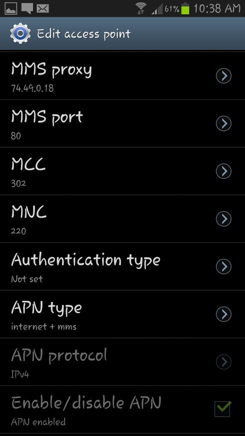

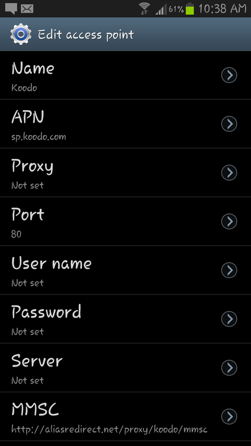

Go into your settings - More settings under wireless & networks - Mobile Networks - Access point names. Then click on the APN named Koodo & make sure the settings are those in the picture below. Then click menu and save.
Then delete any other APNs for any other providers. Also make sure that your phone isn't set to 2g or GSM only. Also make sure airplane mode didn't get turned on.

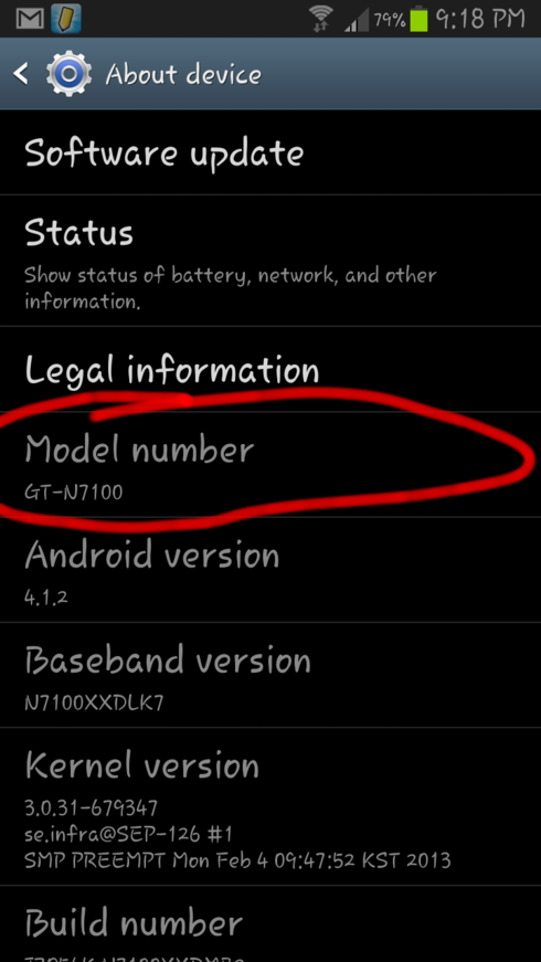

Just because it's from another country doesn't make it an international model. If it was locked to a carrier / purchased from a carrier then it's not an international model. An international model is factory unlocked and was not bought from a carrier. What is the model # of the phone, do you know?
If not go into Settings - About device and it will be shown.

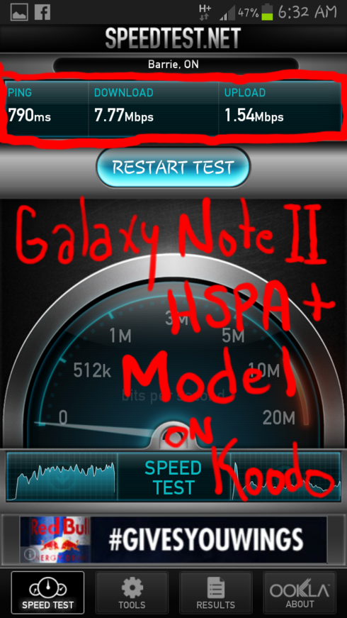

This is the speeds I'm getting on my Galaxy Note 2 HSPA+ model & everything works great and it nice and quick.
